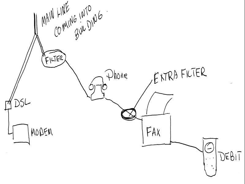

Postby jdarkoregon » Sat Jul 14, 2007 12:27 pm
Kevin,
There is something called a "NID Filter" This filter is placed in the Protector (NID) and filters all the inside wires EXCEPT for the dedicated line to the Modem Jack. They are available from the Phone Company.
If you have a building terminal, then you might have to do something else.
John

Postby sdtripper2 » Sat Jul 14, 2007 1:30 pm
Good call John.... :thumbsup:
oh, yes Kevin...
The filters were about 6 in my DSL setup kit for my parents system....
The filters are put on the phone lines ... You have to have them to
have the DSL work properly. They should have come with your setuP kit?
See this Verizon pdf for an explanation of the filters and installation Kevin.

Postby sdtripper2 » Sat Jul 14, 2007 7:07 pm
Kevin:
You wrote:Can I filter 5 phones with one filter? or do I need one for each phone? The 5 phones in question are connected to one junction box.
According to the guy I just got off the phone with @ Verizon customer
support in India. You can filter 5 devices on one leg of your phone outlet
but no more on one filter device.
Hens teeth would have been easier for
me to get you then getting information about these darn filters from an
Indian tech support person.
So the pic that John shows above without the extra filter would work.
One solution as Johns pic shows and Kerry speaks:
Thinking that you have one line coming in and split that line one going to all
other devices up to 5 on one filter = filter that and one line going on to the dsl as in a split.
Just make sure there is a direct line to the DSL from the input to your
business on the line in question as Kerry suggests and one filter on the rest of the service.
Now this should eliminate your worry about the other line coming into your
business or phones. Your only dealing with the line that is the dsl line.
Isolate that lines devices uP to 5 on one filter.
