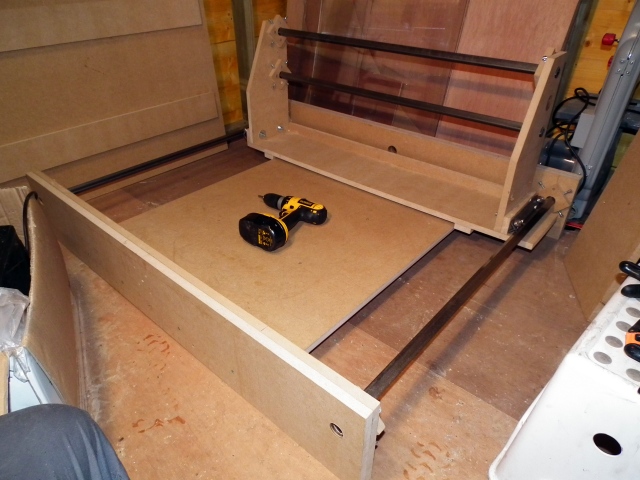

I started yesterday morning, and by this evening I have the X-Axis complete and have started on the Y-Axis.
Usually I would have been further into a project such as this, but I am measuring and re-measuring everything, drilling pilot holes with a drill press, etc,. I figure every ten minutes spent rechecking saves one hour trying to correct mistakes later.
I am building a variant of the JGRO router table.
The X-Axis is quite accurate. It deviates about 1mm in 1000mm. The main bearing runs along steel square section. It is very rigid against pitch and roll, but I noticed a LOT of yaw, so I retrofitted a secondary "anti-yaw" bearing under the gantry base. Unfortunately it is mostly hidden in the photo.
Kind Regards, BigAl.
