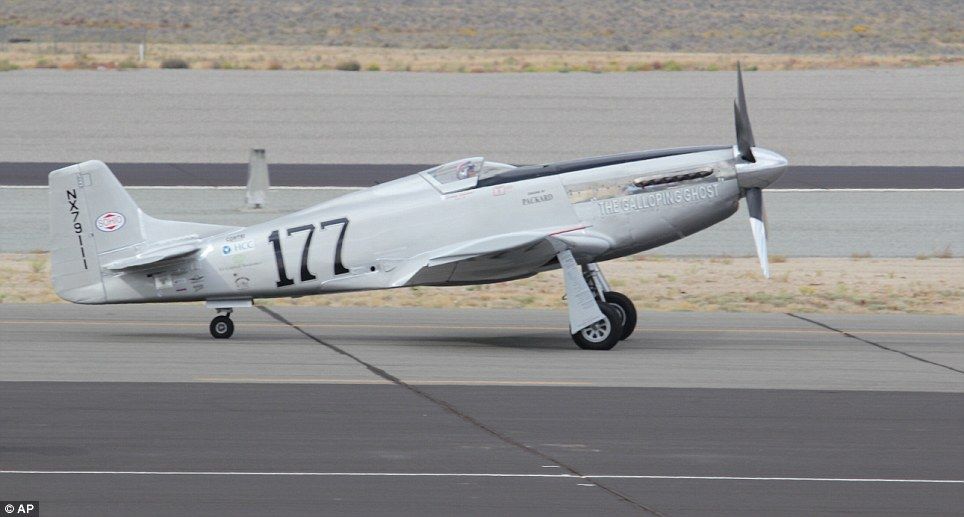

- Photo one is the airplane taxiing, note the pilots head in the canopy.

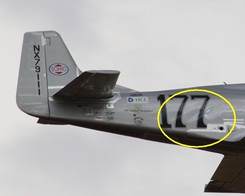

- Photo two is typical oil canning as a result of the tremendous torque these engines put out at high power.

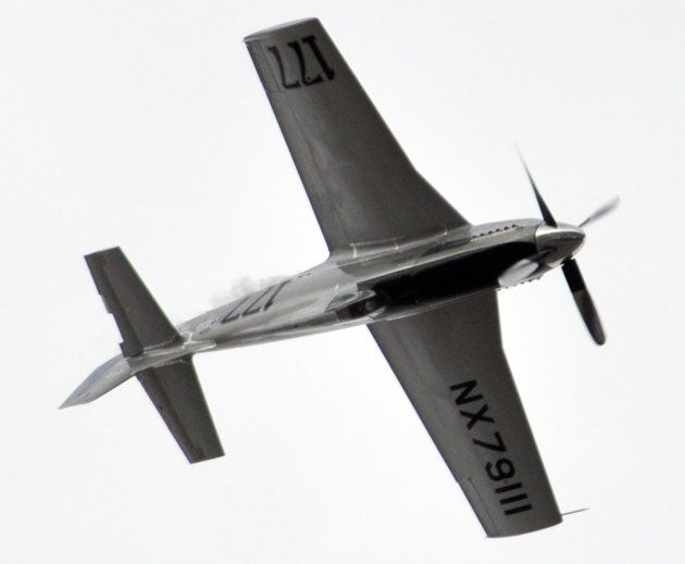

- Photo three is a photo of GG upside down with a missing elevator trim tab.Note all you see is the back of the pilots head indicating he is being forced down in the cockpit.

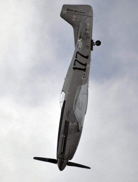

- Photo four is a view of the left side nose down with the tail wheel extended and no view of the pilot. The tail wheel is held up by hydraulics only with no mechanical up-lock, thus indicating a high G-force causing it to extend.

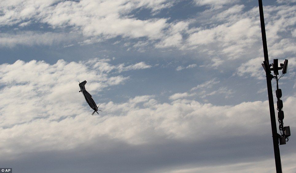

- Photos five and six are from the left side prior to impact, note no view of the pilot and the tail wheel extended.

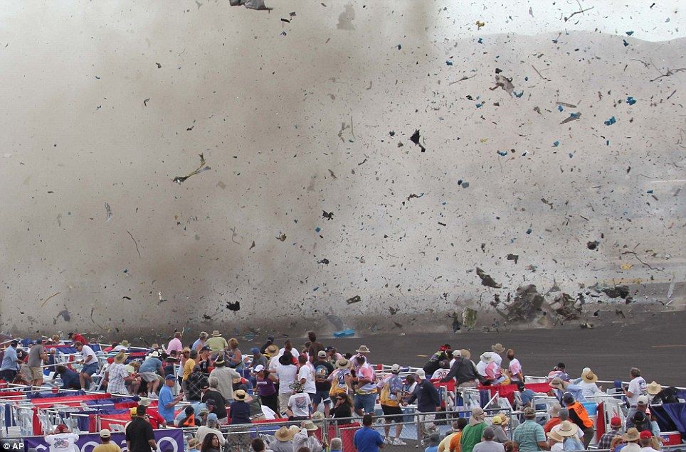

- Photo seven is the debris just after the crash. To the right of center above the crowd appears to be the wing with the leading edge down.
The people were mostly hit by chunks of concrete, asphalt and aircraft debris. They were also hurt by the trampling of people getting out of the way.
