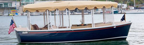

Here is a pic and a link to a converted sailboat. I am sure I could sleep aboard as is but it has numerous possibilities. It is 24 feet in length but there are lots out there that are 18 feet or less that can be towed. http://syracuse.craigslist.org/boa/5813886311.html

I wanted to point out that the linked picture here on the forum is of a Duffy electric launch. The sailboat for sale is a MacGregor 24 and is shown on the Craigslist link, but is not what was pictured on this forum. Converting sailboats can be problematic, as the MacGregor gets its stability from its hull shape and deep swing keel, and the Duffy from its form stability (shallow vee). You can't pull the 575 pound centerboard off the MacGregor without affecting stability pretty dramatically, and no motorboat needs a deep, iron/steel keel. It's just dead weight that needs to be pulled around. (The Duffy is electric powered, so I'd bet a nickel that it has no or very little ballast.)
Thank you for the insight. It sounded too easy. What do you think the advertiser might be driving at?

I'm not sure, but it sounds like he might run a cabinet shop, not a boat yard, and doesn't really understand. His real price (for a gutted boat without interior) is $5,000 with engine. I'm not sure where you are, but here in Washington there are a ton of nice motorboats (designed to be motorboats) you could get, with trailer, for $5,000, and they are even likely to float upright!

All those batteries would make a nice heavy ballast
