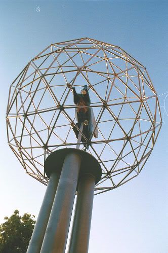

Their greatest attribute is their strength once completed. But all of your triangles are not of equal size. You will be dealing with struts of three different lengths that must be assembled in the correct sequence in layers.
I'd have to revisit the plans but I think this one was about 12' in diameter, it took 330 struts of 3 different lengths and about 600' of SS tubing. I know a guy in Lubbock, TX who who makes a lot of them and has a program that helped me design this one with the appropriate strut lengths and assembly diagram.
I plan on some how incorporating some "Bucky Ball" ideas into my tear if I could ever have enough time and money at the same time to get started. Seems I always have either one ot the other.
