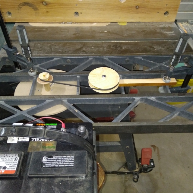

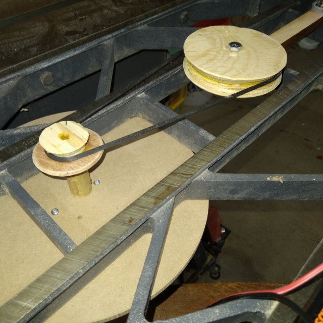

Postby TimC » Wed Apr 06, 2022 1:16 pm
Playing around with some homemade sheaves, a 12v gearmotor and some window screen spline. I had some round plywood cut outs laying around to try.
It wasn't engineered to decrease the rotation of the motor (6RPM) by a defined amount. I'm just trying to get a feel for how the reduction would work. Turns well and the screen spline surprisingly gives good traction. It also has quite a bit of torque but I really don't know yet if it will be strong enough to drive what I'm building. We'll see down the road. Still waiting for the slow boat from China on the control board and 6v gearmotor. I'm getting one RPM on the big end for every 3.5 RPM on the motor. Probably will go for a larger sheave on the output side. Should result in little to no over travel or shaking of the panel frame.
I'm still thinking the final drive will use the GT2 3D printer sheaves and belts on the final design. And the 6 volt gearmotor and tracking board rather than the 12v gearmotor. I don't want to order those until I have an idea that this will work.
Yeah, those sheaves are made from the cut offs made with a circle cutter. The large one is two cut offs glued together and the small is one cut off and just a flat piece of round plywood.
