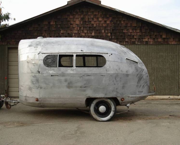

What would look really nice as a strip-plank build would be a Bowlus Papoose.
It can't be built any smaller, since the entry has to be at the front over the tongue, in case anyone is thinking of that. And I do have a set of plans mostly drawn.

It would be a good candidate for strip building :thumbsup: . The skin fairing would require a 2 man fairing board though :lol: The axle looks like its pretty far back?

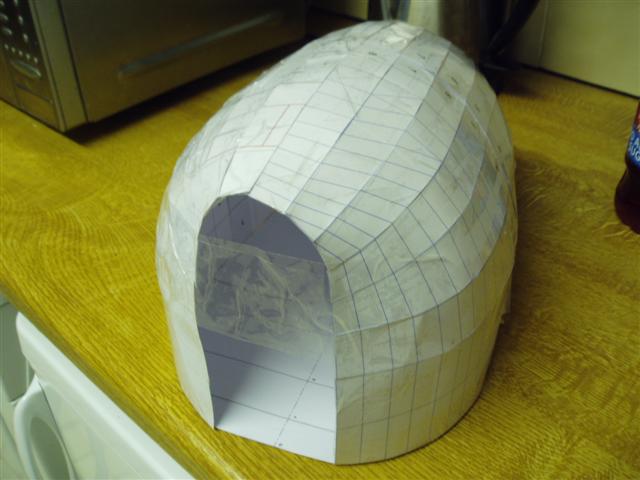

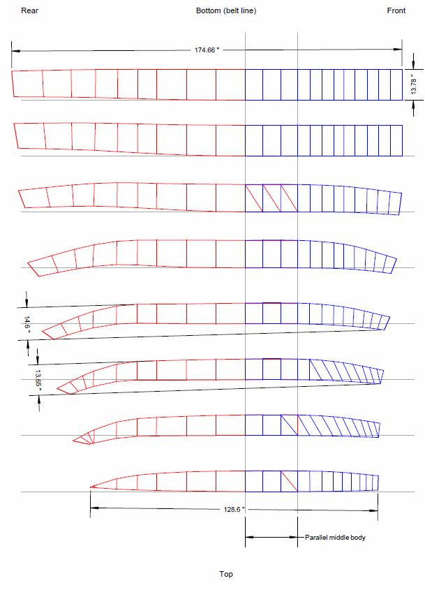

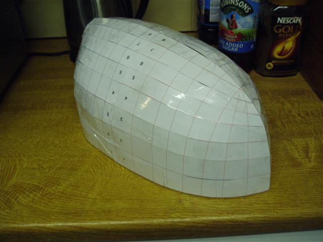

Larry C wrote:It looks like the design might also be a candidate for stitch and glue construction using thin plywood panels.
Well, here is exactly this idea, but at scale size only. I took the Papoose sections and input them into some (free) boat software to generate the strakes shown below. The 'customer' for this job then made a card model by stitch-and-glue (well, sticky-tape) method.
