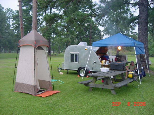

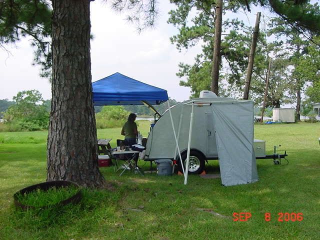

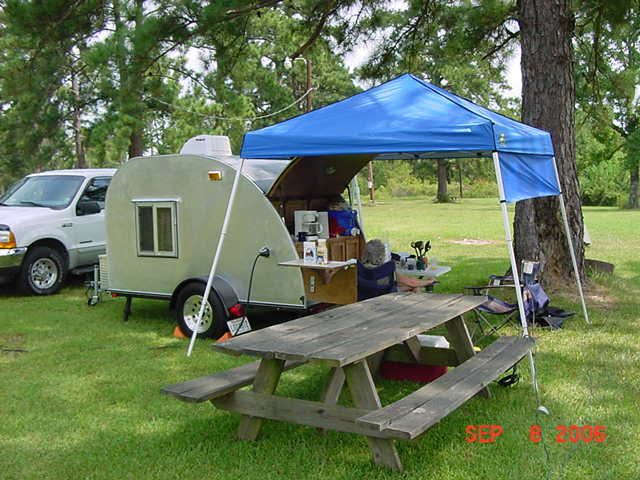

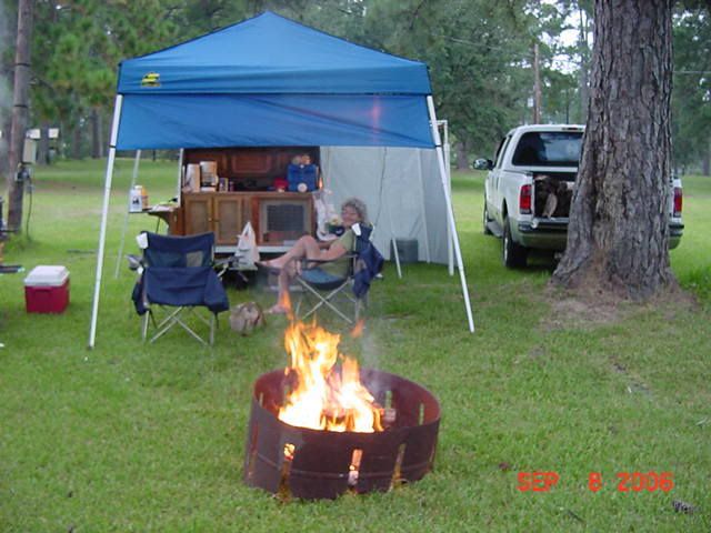

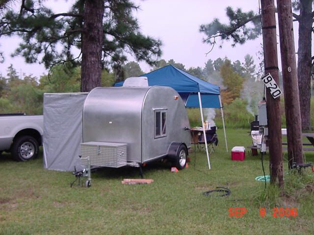

Now for the pics:
pic1
pic2
pic3
pic4
pic5

Nice tear, I liked your camp setup, especially the screen around the door. It looks like its made out of PVC, am I correct?

Yes Jim I made the frame out of PVC. Normally I would wrap the torp on around to completely enclose it, but behind the trailer was nothing but thick brush, we were the only ones at the campground and i thought I would need the other tarp for the quick up to block the afternoon sun. I just made some hangers on the top and used stakes to hold the bottom of the tarp down, It worked out really well.
