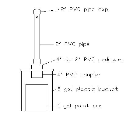

My question is........Have I put together a functional "smoker's station" or have I created an incenerator?
I put 4 of these together to place around the property for the renfaire camping season. I have used one of them in front of a large fan without starting a fire, or even having smoke escape back up the stack. But I would still like to hear from anyone on the group who knows a bit more about such things. It does seem to work, and may be safer than having the campers simply chunk their ciggarette butts on the ground.

That's actually very similar to the smoker's stations we have outside at various locations around the plant. Put a couple of inches of sand in the bottom of your design to stabilize it would be the only additional recommendation I'd make.

Thanks for your replies. I took the top off of a "Smoker's Oasis" outside the resturant where I ate lunch today. It is a simple funnel, I think the extension below the lid on my version creates more of a smoke trap and less of a tendacy to "draw" like a chimney. I'm sure it will keep water out of the bucket (already weathered a couple of rains). Besides the two 3/4" holes near the top of the stack are the only entrance/exit for air so there should be at least some oxygen starvation inside the unit. The rocks around the metal bucket to keep it centered in the plastic bucket serve as ballast, like the sand suggested by Steve.
Wright, your are right. But the entrace to the shower house and the pool have been a "hot spot" for discarded ciggarett butts in the past. Just trying to make it easier for everybody to be more responsiable (or suffer the "wrath of Wright")........ :)

I bought a couple for my business, and they are just plastic with a metal pail inside. They work fine, so I think yours should be OK.

Larwyn, the only thing I see wrong with it is it's plastic..plastic melts and burns..if you can, put a small chunk of dry ice in the bucket before it gets filled up with butts to assist in smothering the smoldering tobbacco.

No - all kidding aside - it should work just fine. ANd since you have them already installed they seem to me working fine. Are there any problems with them tipping over? Maybe a small bag of sand wedgeed in around the paint bucket.

Thanks everyone for all your suggestions and comments. I mainly wanted to put this out there so I could be informed if I had built a fire hazzard. I know someone out there would have pointed out if there were some dangerous design flaw in my version, as compared to the comercial smokers stations.
Actually, in my uneducated opinion, mine seems safer than the comercial plastic models because the bucket and lid are air tight. The only intake for oxygen is the same stack through which the smoke must escape and with the extension inside the lid it is a very poor chimney design. I tried to break whatever rules I know about incenirator/forge design..... :thumbsup:
