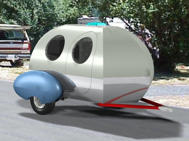

Postby mikeschn » Wed Nov 01, 2006 7:48 pm
Alan,
Will you build a Roswell? Pretty please? ;)
Postby ALAN GEDDES » Wed Nov 01, 2006 9:52 pm
I need a source for really Cheap foam for the funky fenders. I believe the ideal stuff is the green florists foam as you can disolve after glassing. And it is expensive in large pieces. Somebody correct me if I'm wrong. I really like the one angib drew up.

Postby dwgriff1 » Wed Nov 01, 2006 10:46 pm
A friend, who has been building airplanes suggests using cheap foam to get the shape, then covering it with a thin layer of dry wall cement, sand that to contour and glass on top of that.
The foam is just an easy forming material. It could be plaster, wood, or cow manure.
Making a mold from that foam/drywall mud combination would be a lot of work, but so would finishing the surface without a mold.

Postby ALAN GEDDES » Thu Nov 02, 2006 1:51 pm
Mike: Come spring I will build it but it will be a bit more Starwars/stealth looking. I want to try foam insulation sheets with ply ribbing and cover with resin and cloth. Flat black paint and dark tinted plexiglass windows with gull wing doors maybe. Will build a model soon.

Postby apratt » Thu Nov 02, 2006 2:22 pm
I have used the cheap white foam and painted it with water base house paint then fibreglassed over that. The water base paint kept the resin from melting the foam.
