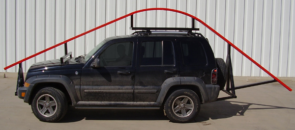

Postby Bigwoods » Fri Jan 19, 2007 11:29 pm
Thanks to everyone for the suggestions. I gave him the information. Some great ideas out there.
Jiminsav,
He said it didn't work. Now, do you know anyone that can weld a bumper on a Jimmy?
