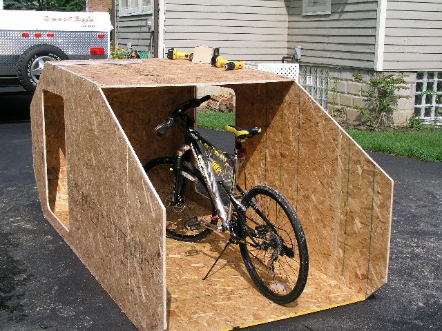

Also look at this picture... It shows how I could design a squared teardrop to hold 2 bikes!!!
