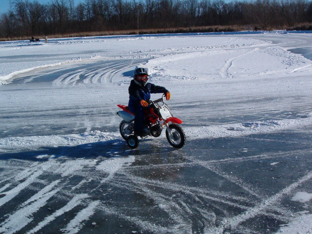

I have been living on the Fox River here in Green Bay for 6 years now and have a cyclocross bike I put ice/studded tires on. It is very relaxing and fun. Also do the motorcycle version. Here is a picture of the little guy.
