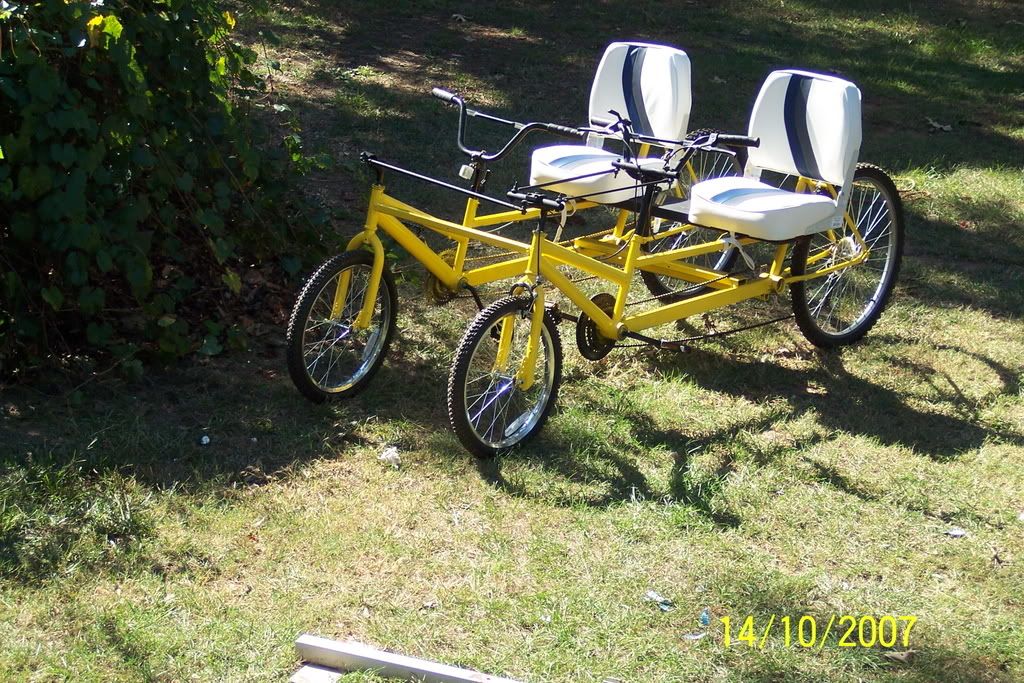

Postby rbonner » Sun Oct 14, 2007 5:04 pm
After looking for somthing diffrent ,I built this for my wife and I. Both can pedal or just one, but only the driver steers. You can be in diffrent gears for however you like to pedal. have a little trailer I have to finish with a cooler on it for going to the camp store. Making the surry top for it this week. Image

Postby rbonner » Sun Oct 14, 2007 6:49 pm
I can pick it it up myself and put it on the bike rack . I saw somthing like it on line...but I wasnt about to pay the $1800. they wanted for it. Heres where i got the basic Idea http://www.ultimate-quadracycle.com/sho ... tster.html

Postby steve wolverton » Sun Oct 14, 2007 8:04 pm
Very cool indeed. Will it fit in the back of the truck so you can take it camping? It looks like a couple of 20" BMX bikes, and a couple of 26" mountain bikes that were cut, and extended with square tubing?

Postby rbonner » Sun Oct 14, 2007 9:10 pm
Steve, thats exactly what it is. yes it fits in the truck but I put it on a bike rack on the back of my "cough" fith wheel"cough" . Deputydog, some where i have pics, but if you look close you can see where i cut the bikes.

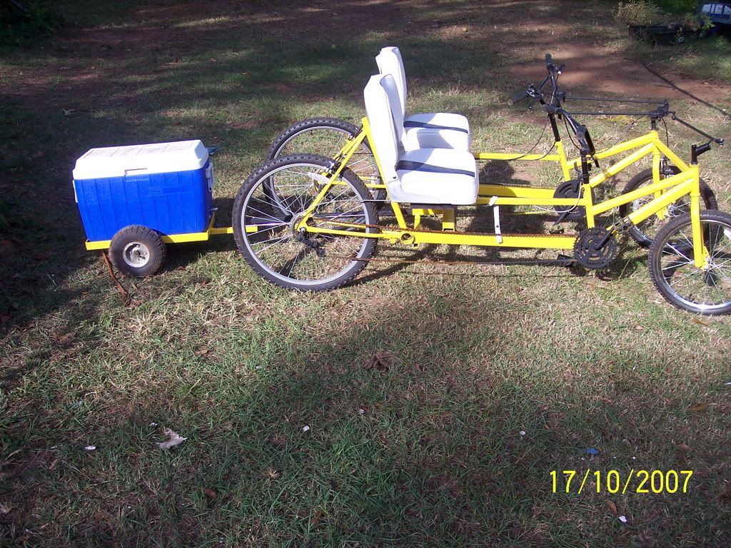

Postby rbonner » Wed Oct 17, 2007 9:43 am
Bill Fernandez wrote:Now I like that how much would one like that cost and how would you get it to the camp ground? 8)
2 26 in mountain bikes from walmart at $59.ea. and 2 kids 20 in at $24. ea. 2 extra chains to lengthen them. $48. for both seats. Beetween $275 and $300 in it. haul it on the bike rack on the back of my camper or slide it in the bed of my truck. Made a little trailer for going to the camp store for ice or whatever. Image
