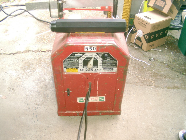

Postby cablerunners » Tue Mar 18, 2008 6:26 pm
Hi Deacon,
Sorry to hear all the trouble you're having...
I rented and old arc welder for about $30.00 a day. Did most my welding over a weekend...
Later, I just bought off craigs list for about $85.00. It's not a MIG but it works...
-phil

Postby cablerunners » Tue Mar 18, 2008 10:17 pm
Hi Deacon,
The welder I showed above is 220... Plugged into my dryer outlet.
I got it from a local rental shop...
Good Luck...
-phil
