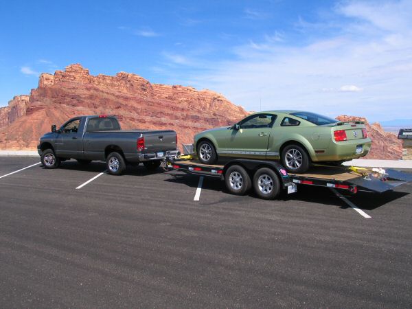

I would move it back about a foot and try it there. Generally as a rule of thumb, you should have the back wheel of the car just barely behind the rear trailer wheel, like the rig I have posted below. I pulled this one from San Diego to Minneapolis (about 2000 miles) last spring. I repositioned the car on the trailer twice before I wad satisfied with the balance. It may take a little trial and error on your rig too. You'll be surprised how much difference moving the car just a few inches will make in the rig's handling.
This was my rig at a rest area on I-70 in Utah.

Thanks for the tips, that was pretty much exactly what I was looking for. I was concerned because it just didn't look right to me. I think I'll pull it back to where the hub of the car is inline with the rearmost edge of the trailer fender, kinda like the way Joe has his.
