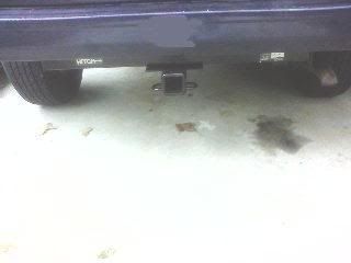

all my twisting and turning and greasing up paid off today...finally got that hitch on! :dancing
now...i just need a trailer to put it to use!
