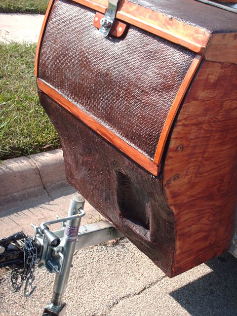

This is how I built the front part of my tongue box, using Great Stuff!

Postby Prem » Wed Nov 25, 2009 12:42 pm
Todah,
Is that fabric on top of wet foam pressed into it? Painted after?

Postby Todah Tear » Wed Nov 25, 2009 1:06 pm
No. I formed a cavity of about 2" with wall paper and wire mesh from one of the wooden sides of the box to the other. I poked some expansion relief wholes for the excess to bleed off. I then Great Stuff filled the cavity with Great stuff. I glued that micro-bubbled drawer liner to the outside to form the basket texture, and then coated it with bedliner, spray painted it and then added several coats of Helmens Spar polyurethane for UV protection and shine. The wall paper was used to guide and control expansion. If I had have used just the wire mesh, the foam would have expanded right through it and then I would have to deal with spilliage control before it hardened or I would have had to sand everything down to match the contour.
One thing to remember with this stuff is DON'T GET IT ON YOUR SKIN or it is there for at least a week...provided you wash the area everday. If some of the stuff spills over on something, don't try to wip it up. Let it harden and it will just pop right up. If you smear it when it is wet, you have just made a problem for yourself.

Postby Prem » Wed Nov 25, 2009 10:35 pm
Todah,
Cool! 8)
What kind of wire mesh...expanded metal? (Looks like.)
You chose that method to insulate the box or to get the curve you wanted? Or both at once?
Prem :thinking:

Postby Todah Tear » Wed Nov 25, 2009 11:21 pm
Prem wrote:Todah,
Cool! 8)
Prem :thinking:
Thanks, I actually chose it for both reasons, but more for the curve. The wire mesh is covered up. The pattern that you see is from the drawer liner (sold at Dollar General store, Wal-mart, etc.).
