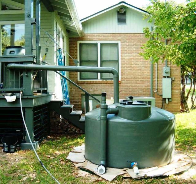

My mother in law wanted to collect a little rainwater for here plants.
She already had gutters, and came up with a 550 gallon tank.
Here's what I did with that and a bunch of 4 inch pvc pipe, and paint and scrap metal and........

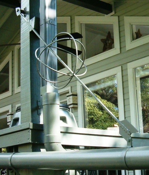

I needed to support the 4 inch pvc from the "first wash" tank to the main tank, so I fabricated this Armillary Globe and Arrow instead of using something more simple (and ugly) such as cable or chain.

It filled a couple of weeks ago. We had almost a half inch of rain overnight and the tank was near full. A couple of days latter we got over 2 inches of rain. That's why the overflow pipe is the same size as the feed pipe. It reverts to a simple downspout. She needs a bigger tank!
Actually we knew the tank was under sized, but it was free and much larger than the rain barrels that are so popular here in the Texas Hill Country, all the plumbing to fill it is exactly what it would take to fill a much larger tank. There is 1000 square feet of roof feeding the tank. A 5000 gallon tank would not be out of the question in our area. The average annual rainfall here is about 32.5 inches. The rest of the roof (more than half) is still draining onto the ground. This little tank is likely just a preliminary step in the testing before a much larger system, employing most of the roof will be built. Only time will tell. At the present time water is so cheap that payoff on a system like this is many many years unless you scrounge material and do all the work yourself.... :lol:

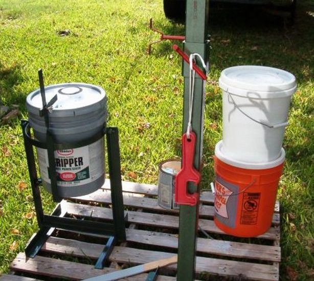

When it came time to paint the rainwater harvesting system, the primer which makes the paint stick to the plastic was purchased in a 5 gallon bucket. I am not a painter and was a bit curious as to how I was going to dispense the paint into a smaller container for use without wasting half the bucket of primer.
About that time someone on one of the welding groups posted a picture of his version of a "bucket tipper" for just that purpose. I did not know that such a thing existed, but it looked like a good idea to me. The tipper allows you to pour paint from a 5 gallon bucket with one hand, and very easily. The one I built is not as fancy as his, it is based more closely on those which are available commercially. It worked well and never spilled a drop after I went back to the store to get the pouring spout to fit the paint bucket.

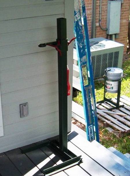

I also welded up a little stand to hold my 1/2" Milwaukee Magnum Hole Shooter with a paint mixing attachment on it. I built that one tall enough to work with a 5 gallon bucket while still in the bucket tipper. It too proved to be a worthwhile project and I even used it when mixing the paint in a 1 gallon pail. Also the drill adapter that I made simply bolts to the short bit of receiver tube that allow for height adjustment. That means I can build adapters for other tools if such a need arises, or even a holder for a bottle of Guinness....:lol:
The bucket tipper;
The mixer stand;
