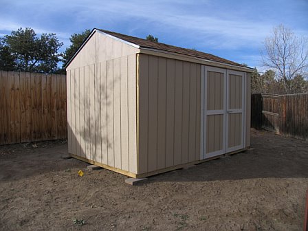

I built a shed a while back. I used a shed kit I got from Lowes.
I think ours is around 8x12, but I can't remember for sure. I would definitely get as large a shed as you can fit as they seem to fill up quick. I was NOT happy with the quality of the wood that was included in the kit. Now I know where the warped, cracked 2x4s go that no one will buy at Lowes, they put them in the shed kits! Also, the instructions on how to assemble the shed were weak (I don't care what the plans say, don't sheath the frames on the ground!).
I would just buy shed plans with a materials list instead of a kit if I did it over. And just like a teardrop, it took 3 times longer to build then I thought it would. :lol:

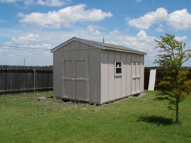

This is the 10x16 shed that I built back in TX, I used a set of UcanDo plans from Lowes. When I was pricing out the materials, I found that Hardee Board was only 3 or 4 bucks more than regular wood per sheet. I used that because termites are a problem in TX.
I chose that size because it meant less cutting and waste, I used boards cut to the size I needed. I "customized" it by adding a 5ft door on the gable end. I can get stuff in and out without having to move the lawn tractor every time.
I also built it taller so that I could put a loft over where the tractor was parked, and have enough headroom when I hoisted the car's hardtop up for storage. Actually, that was a mistake that worked out for the better. I didn't see that the plans called for a 6 1/2ft height instead of 8ft.

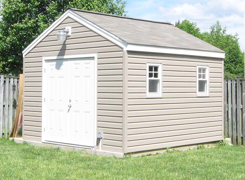

We had this shed built two years ago. 12'x12', insulated, 110V and 220V electric, windows, lights inside and outside, with a concrete pad that was 13'x15'. (They had extra concrete, so they wanted to know if we wanted a bigger pad...) That was a huge mistake -- when it rains the water would hit the pad and run under the shed walls. We had to spend another huge chunk of money to get gutters and waterblocks/sealant installed. But now that it's done, it's nice. I've worked on some carpentry projects in there, including my trailer cabinetry. We still need to put in some padded flooring that will stand up to sawdust and be easier on my feet/legs than the concrete, and we need to install A/C and heat so I can stand working in there when it gets brutally hot or cold.

Postby Creamcracker » Sat Jan 29, 2011 11:02 pm
digimark wrote:We had this shed built two years ago. 12'x12', insulated, 110V and 220V electric, windows, lights inside and outside, with a concrete pad that was 13'x15'. (They had extra concrete, so they wanted to know if we wanted a bigger pad...) That was a huge mistake -- when it rains the water would hit the pad and run under the shed walls. We had to spend another huge chunk of money to get gutters and waterblocks/sealant installed. But now that it's done, it's nice. I've worked on some carpentry projects in there, including my trailer cabinetry. We still need to put in some padded flooring that will stand up to sawdust and be easier on my feet/legs than the concrete, and we need to install A/C and heat so I can stand working in there when it gets brutally hot or cold.
That looks like the quality shed I want to build. I'm probably going to put mine on a pea gravel pad rather than a concrete pad...that way I'll put in a wood floor.

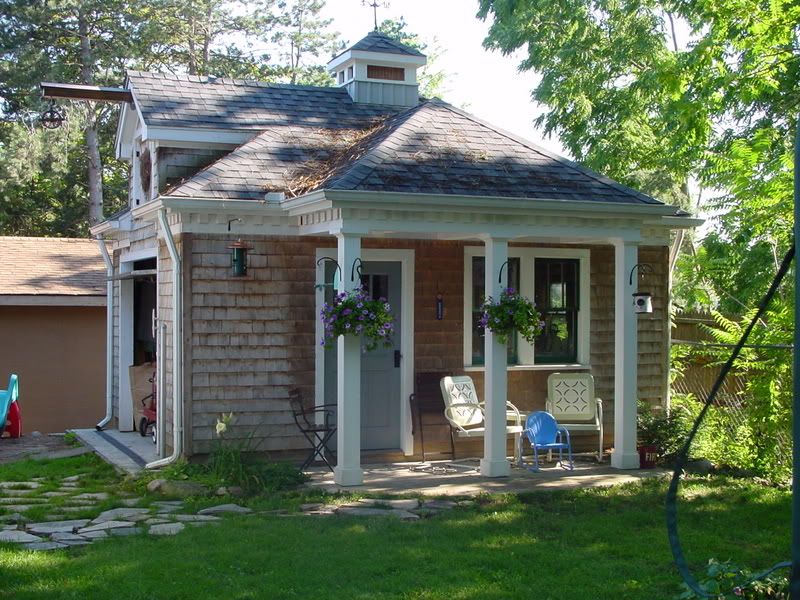

As 48rob says, sheds approaching a certain size lose their price advantage over a garage pretty quickly. At various lumber yards I worked at, customers would often buy 12' wide shed packages 14', 16', or even 18' long. The advantage being that a "non-permanent" structure (one that is not built on a cement pad or foundation) could be erected w/a permit. However, at those sizes, a bare bones garage package could have been bought for less money.
This is my 14x18 "garage" (actually, it's technically a pole barn), which I built for $5,000 (plus gutter installation, which was part of the price when I had them installed on the house). Getting a permit can be easy enough for a homeowner, depending on location. You might be able to get a permit with little more than a couple sketches.
