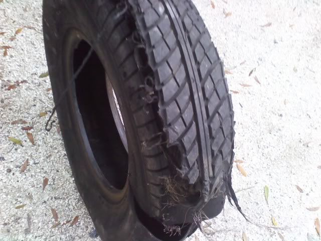

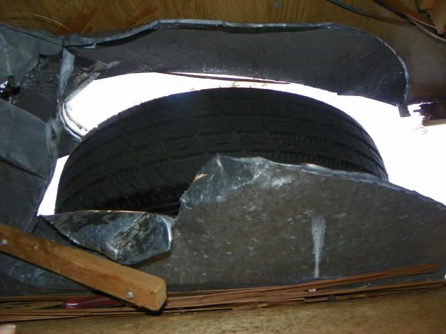

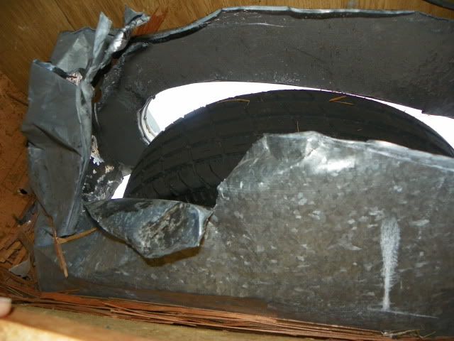

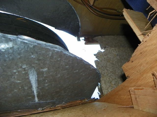

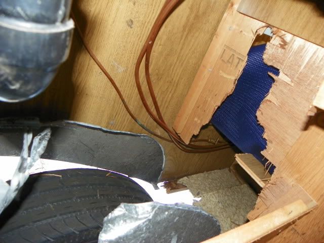

A lot of you know about the little blowout incident I had on my Scotty trailer on the way to Ocala, FL to our "Women in Tears" gathering earlier this month. Well, I hadn't looked at it since I got back so today, I decided to uncover the damaged area and take a closer look. I did find more utensils, (one of them went through the sidewall) a bit with road-rage but some are keepers.

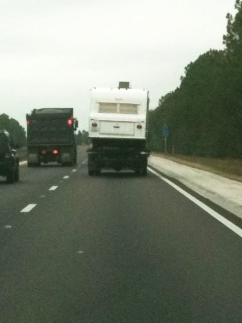

The blowout on Interstate 75.

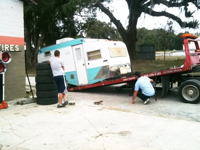

My baby getting loaded up.
Poor baby....
The best tow truck service I've ever had! And tire store was awesome!

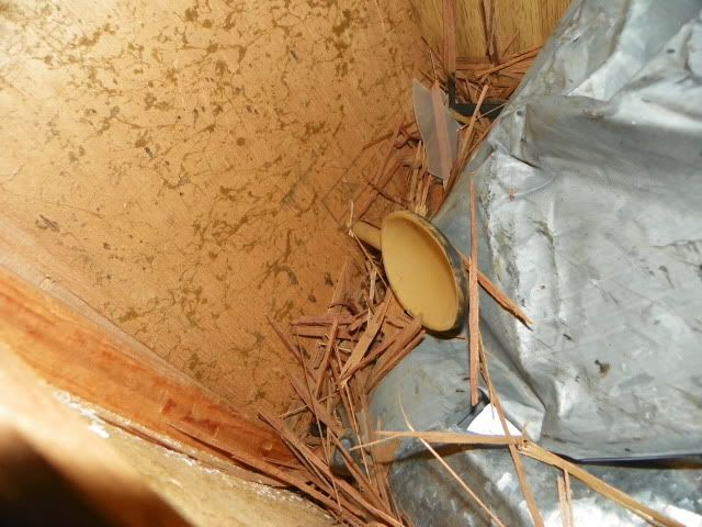

See that long tan spoon? It was driven through the inside wall under the stove. I couldn't figure out what it was till I pulled it out.

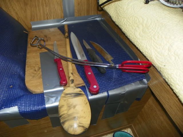

Found more utensils in the mangled mess! Check out the twisted tongs and more knives with no handles. I'll just add these to the other salvaged souvenirs!

Ok, back to work...This is what's left of the drawers that were inside.
And more I had already cleaned out today.

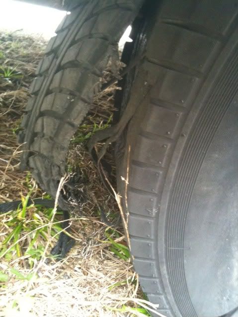

Were you able to figure out why the tire failed? e.g. penetration, somthing on the road, old age (more than 8 years old)... Always looking for what went wrong.

I think the Florida sun/heat got the best of it. It was showing crackling on the sides and I had plans to replace them soon but obviously it wasn't soon enough.
When I got on the road I knew something wasn't right by the way it was riding and planned to pull over at the next exit to check the air, which I normally do before a trip but failed to do this time. The blowout happened shortly thereafter. I was going 62 when it happened and was fortunate to "use my head" and not "lose my head".
That taught me a valuable lesson! I bought 2 new tires that day and I'm so gun-shy about this happening again that I want to buy new tires every year now. Probably overkill but I don't want to experience that again.
All the damage to my cabinets came from loose rubber hitting it.
Notice how it split in half.

8 years from date of manufacture is supposed to be the limit on tire age. http://www.tirerack.com/tires/tiretech/ ... ?techid=11

Postby Miriam C. » Mon Feb 28, 2011 11:42 am
:( :cry: Wow Becca, that is just awful! I wonder if you can make some metal spars across the wheel well so this doesn't do that much damage again! Just plane scary!
Postby TENNJIM » Mon Feb 28, 2011 12:59 pm

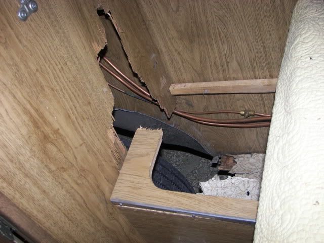

Becca, I am amazed at the damage to your Scotty-did not realize a blown tire could do so much. Feeling your pain, but mighty glad you are okay. Sometimes, a blowout can effect the tow vehicle handling.

Miriam C. wrote::( :cry: Wow Becca, that is just awful! I wonder if you can make some metal spars across the wheel well so this doesn't do that much damage again! Just plane scary!
Thought about that when I was looking at it yesterday. Have to look into it when I get the wheel well fixed.

Trailer tires are generally recommended to be changed after five years. They can look good but you are right about the sun doing big damage on them that you may not notice. Trailer tires are also a bit softer on the sides.
I had a blowout on my trailer a year ago, my own fault. I had misread the recommended inflation and had twice the air I needed. It left suddenly between Phoenix AZ and the CA border. I use Coach Net insurance and they got some one to help me who could inflate a seldom used spare. I think they came from 50 miles away. Good thing he brought his beefy son, there is no way I could have gotten that tire off even if I wanted to. Fortunately there was a tire place two exits down the road.
I was luckier than you and had zero structure damage, just one bad tire.
