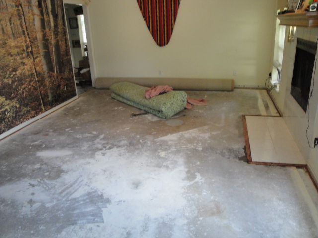

Well, I have removed the carpet and padding. I also removed some ceramic tile that was in the foyer and some that was used as the landing for the fireplace. Eventually, the ceramic tile that frames the fireplace will be removed and replaced with glass tile.

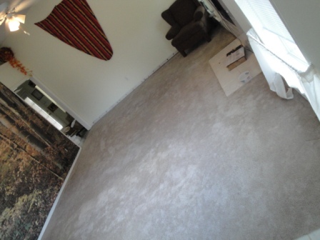

BEFORE - Carpet still in place
Carpet Removal
Fireplace landing removed

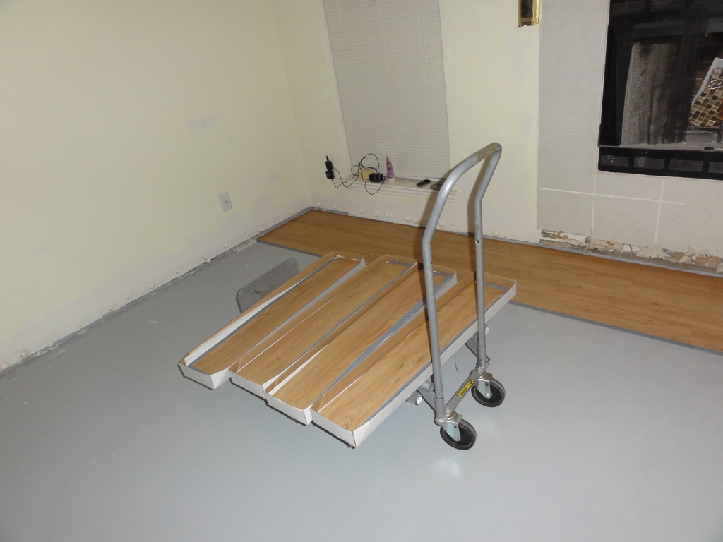

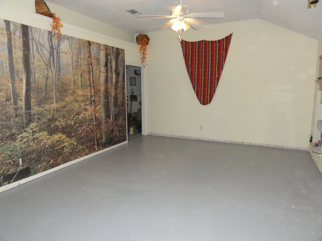

Flooring will be delivered tomorrow. I'll Kiltz and paint the drywall and baseboards once tomorrow.
Sealed Floor (Evidently, I got dust inside my camera lens compartment the other night - white blotches)

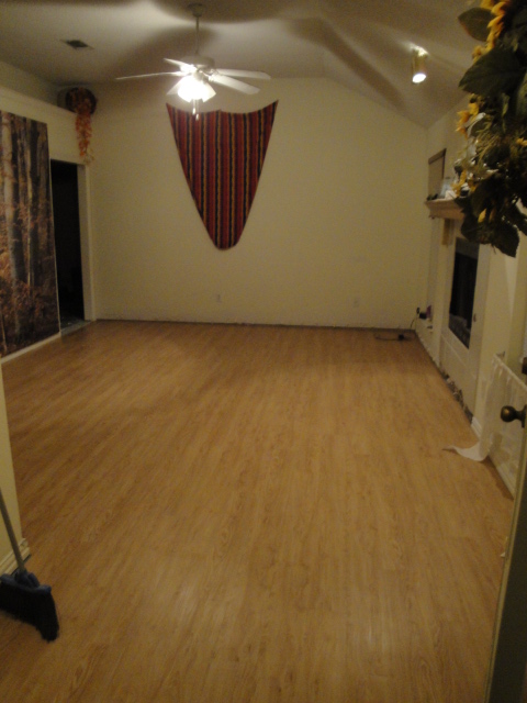

After this weekend, I am 85% done. I still have to touch-up the wall paint and install the base boards and quarter-round. The flooring took about 8.5 hours, split between Saturday and Sunday.
Flooring:
