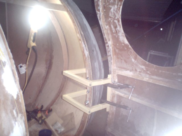

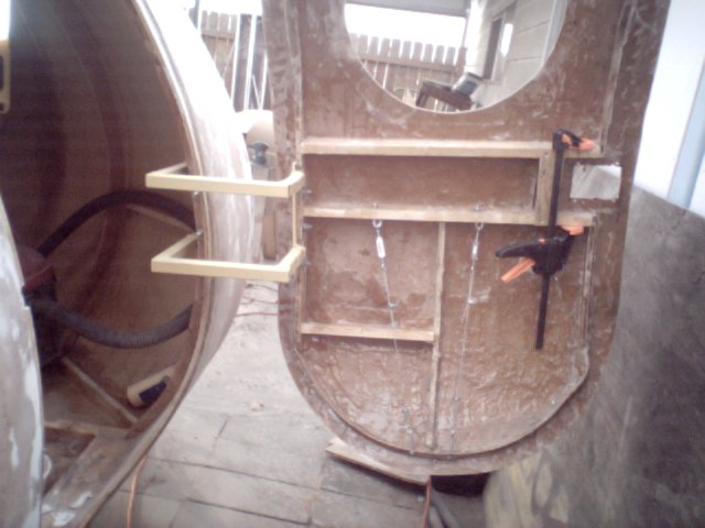

Here's a couple of pics from his album, showing how Del did that 'door with the wicked hinge':

Postby Dean in Ct. » Thu Jan 10, 2013 6:57 pm
What I said!
Way cool!
