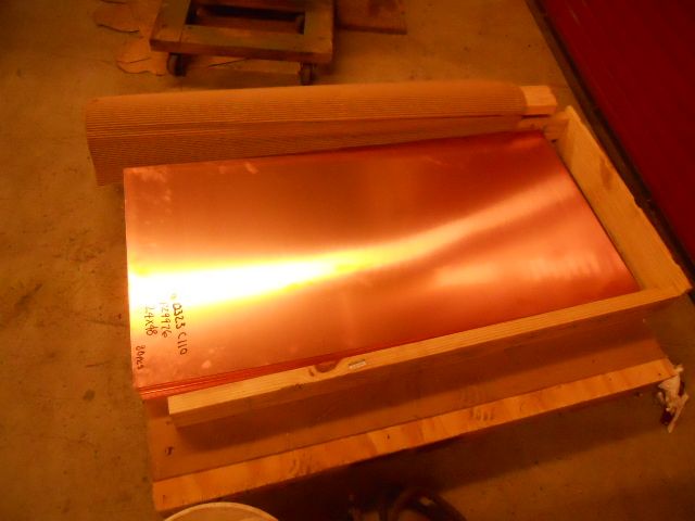

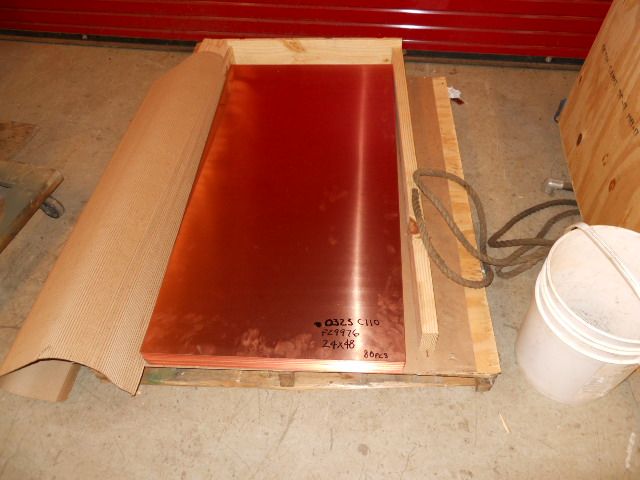

Was given a pallet, 80 sheets of 20 gauge (.032) 2' by 4' copper and essentially told to copper clad the keel of our whaleship, the Charles W. Morgan.

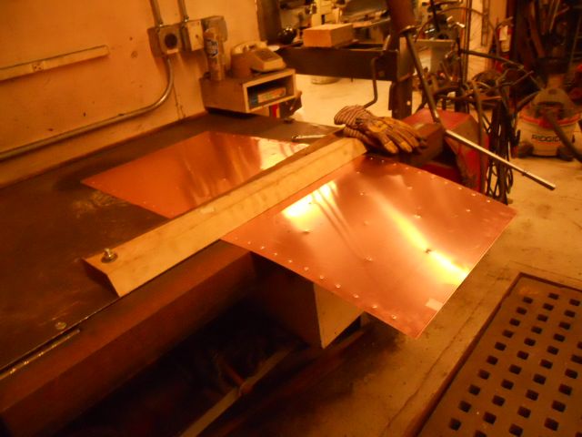

Had to build a 4' brake
Bent the first piece, the most difficult...

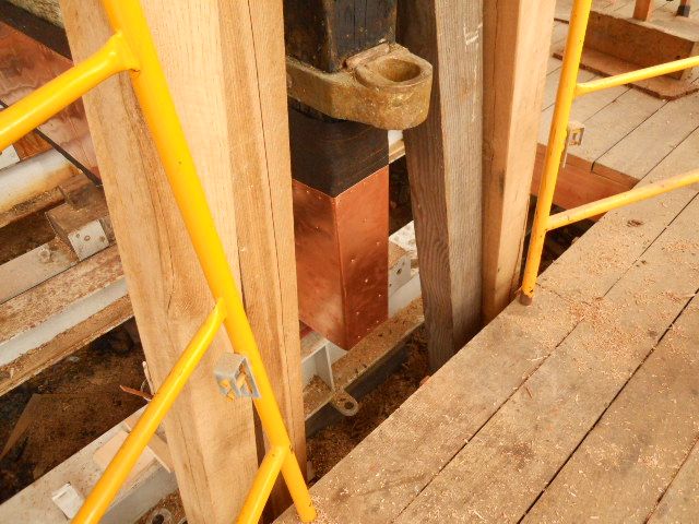

Put it on the back end of the keel at the sternpost

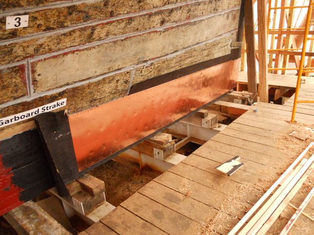

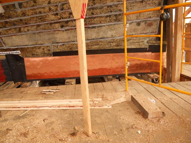

Then began working foreward
I have to do both sides then create a bunch of troughs to do the bottom surface and overlapping the lower edges of the pieces I'm working on now.
