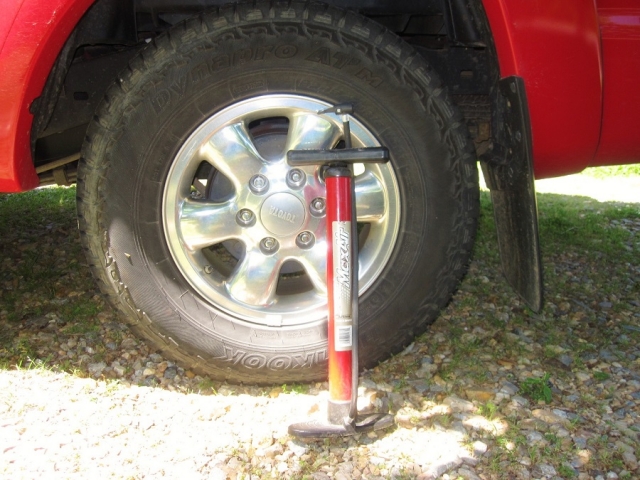

My small12vdc pump is more'n 20yrs old & sadly lacking in volume (takes 'forever' to air up a 235/75R16 tire to 36psi). This one takes less time but lots more energy - MINE :R Good exercise tho...
