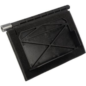

Though my experience with Fords is limited, and I have never seen a working temp gauge show stone cold (even with thermostat completely removed- I drove my Chevelle to work like that once, heater still worked, before I turned it into a race-only car), I have a couple of thoughts here. If you are driving the '95 FORD EXPLORER, as shown in your signature, it is known to have two heater faults that are common. The heater control valve on the hoses to the heater core or its' actuator,
or the "blend door"
dorman door.jpg (11.89 KiB) Viewed 1556 times
or its' actuator.
Or the blend door could be sticking closed because it is cracked ('95 doors were ABS plastic, known for cracking). Here's a link to a forum with a fix http://www.explorerforum.com/forums/showthread.php?t=294140 or there are several on YOU-TUBE. I have had the opposite problem with my '04 Chevy 2500HD pickup....blows hot in summer! The blend door actuator has opened the heat door 3 or 4 times, but not a big problem...I just pull over, turn the ignition off for 15 seconds, and restart. The blend door resets to normal. Hasn't happened for the last 5 years, so I never replaced the part. See, even Chevies have (some) problems too.
