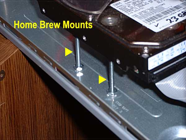

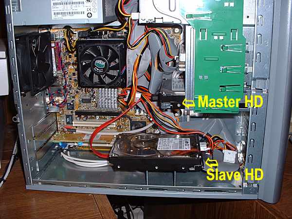

Recently I purchased a new computer. I wanted to use an old 23GB HD as a backup and storage device. So I figured out how to set the new computer HD as the "Master" and then added the other HD as "Slave" All worked well except that there was no place to mount it.
The bottom of the Slave HD has holes for mounting bolts. So I drilled four holes in the bottom of my new case. Added four bolts and put it in. I raised it up so it would not interfere with any of the other components and also be in the flow of the fan air stream.
Maybe it would work for you...

Just wondering why you did not put the slave right above the Master? Maybe I can't see good enough, but it looks like an open space there.
Edit: I forgot to say that I think you solved your problem in an ingenious way and it should work fine for you. Good job! I actually have several PCs with extra HD just laying on the bottom of the case. (Don't try this at home unless you NEVER move the PC when it is powered on)!!!
Hi Toypusher!
All the bays were filled with other stuff.
