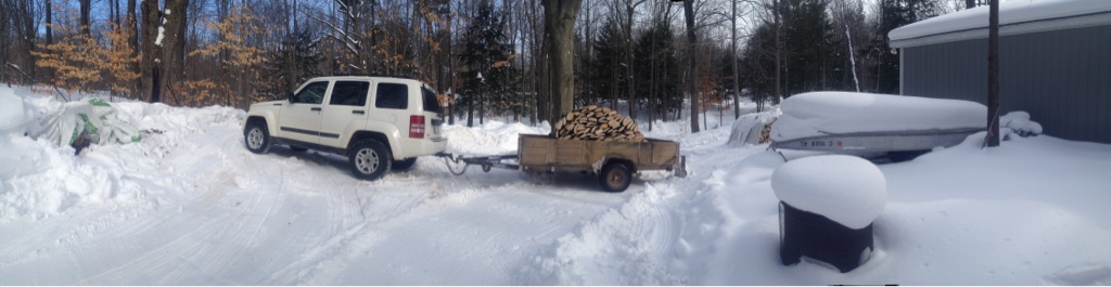

I stripped a popup to just frame and added a 5/4 tongue and groove deck and sides. It was an Apache popup, my utility trailer was about 50" x 9' it weighted 400lbs.
Here's a pic of it loaded, I used and abused it. Knew I was pushing my luck with the frame getting bad. Sold it to my friend, thought he'd fix it then use it. He used it until he knew he was pushing his luck and spent time this winter rebuilding frame. But it sits unfinished.
