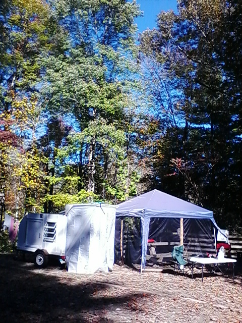

We have a fairly unique Teardrop.....Miss Piggy.
And we use both a 10'x10' Ezee up (Broadstone brand) and a 12"x12" (Coleman brand) as protection from rain and sun??
Last season I built a "Privacy Room" from a recycled/repurposed ezee up frame I found at the dump.
It is 4'x6' and stands (attached to MP via lower pull outs) under either of our ezee ups. It has a zipper entrance, and gives Sandi total privacy to open her door, get out, get changed, etc. etc.
There is room for a luggable loo, folding table, clothing hooks etc.
Very light weight, folds up and fits in a lawn chair bag, and sets up in under 5 minutes.
Cost was only the cost of the "rip stop nylon". out rigger ropes, zipper, and Velcro tabs.
Works Great! :thumbsup:

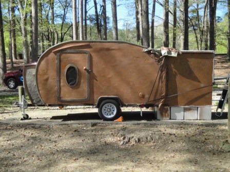

I added a 4 ft extension to one of my campers. The extension was wood framed with coroplast sides.
