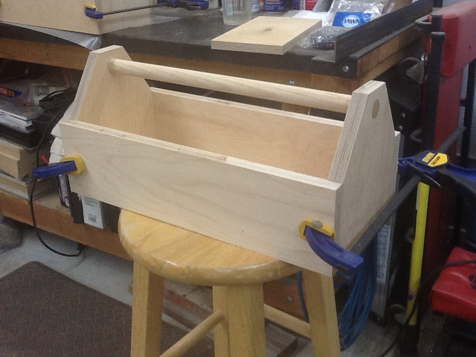

Postby ratrod71 » Wed Nov 16, 2016 10:42 pm
Took some of my scrap plywood and made a couple of tool boxes to give as Christmas gifts.

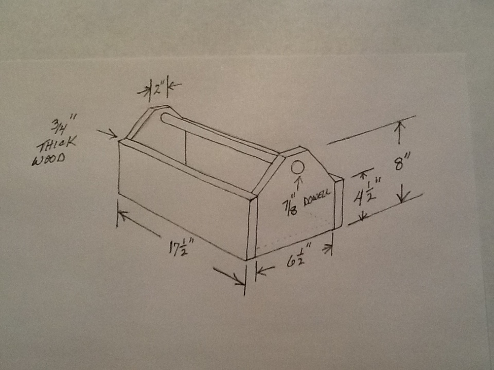

Postby ratrod71 » Sat Dec 03, 2016 1:58 pm
Dimensions for the tool box.

Postby tony.latham » Sat Dec 03, 2016 2:38 pm
Ratrod:
Thanks for cranking the dimensions out. I've got so much "scrap" wood, it's getting in my way. Looks like a "this-month's-project."

Postby ratrod71 » Fri Dec 09, 2016 11:04 pm
I am sure you talented builders can figure this out, but the dimension I forgot to mention was the bottom board of the toolbox. It is 6 1/2" X 16".

Postby tony.latham » Fri Dec 09, 2016 11:30 pm
Ratrod:
Too late. :oops:
I cranked two of these out today. Thanks for the motivation. :thumbsup:

Postby tony.latham » Sat Dec 10, 2016 11:01 am
You Da Man.
No... you da man!
I used 1/4" subfloor for the sides 'cause the recipe called for scrap wood. In fact one of the ends was made out of 1/2" ply instead of 3/4". The only thing I bought was the 1 1/8" dowel. Today or tomorrow I'll slather a coat of The Mix on 'em but that'll have to wait until I've snowblown 10" of white stuff off the drive way.
These are going to be damn handy. I'm frequently hauling tools around the house and outside. Thanks for the catalyst.
