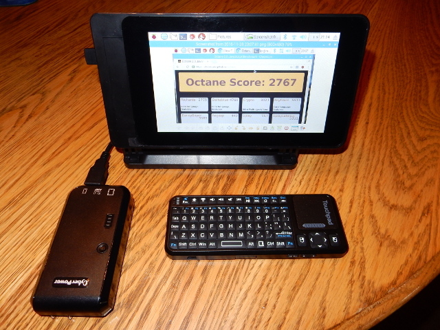

Postby mikeschn » Tue Dec 06, 2016 6:57 pm
I picked up a Pi2B. I though I'd print up a clamshell case and make it small enough to fit into my pocket. It wasn't packaging very well. And surfing was too slow.
Many many months later I assembled a newer Pi3 into a SmartiPi Touch case http://smarticase.com/ . It's nice, but doesn't fit in the pocket. :? Surfing is a little better... the Octane 2 benchmark is 2700

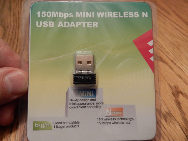

Postby mikeschn » Thu Dec 08, 2016 5:44 pm
Alan,
BTW, this came with my RPi2. Why couldn't one use something like that on an Odroid C2?
