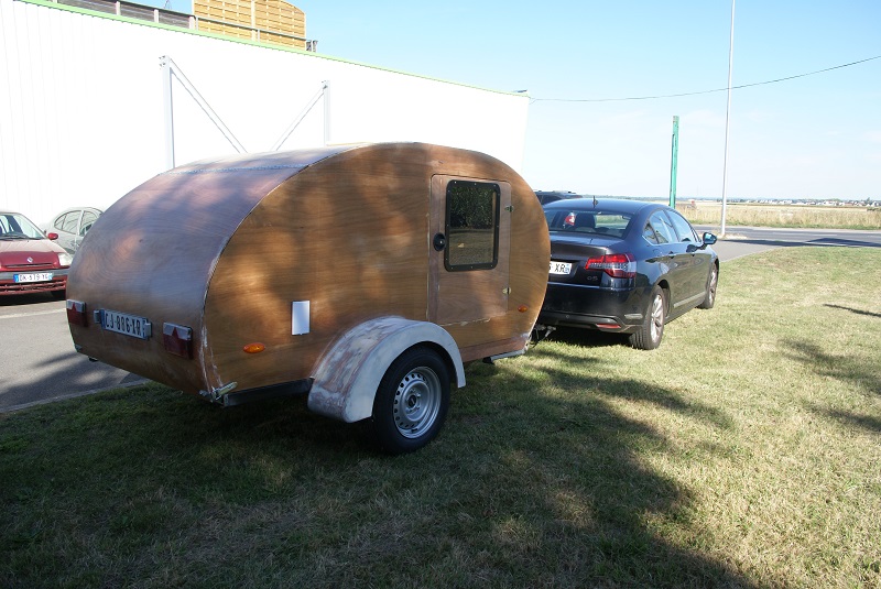

I am bad in English here is my tear
DSC09160 l.jpg (181.2 KiB) Viewed 4524 times
DSC09159 l.jpg (189.68 KiB) Viewed 4524 times
DSC09158 l.jpg (197.38 KiB) Viewed 4524 times

What a beautiful little trailer.
:applause: :applause:

I see no hatch, so it's a 'Sleeper'! Very nice build!
Now, explain it a bit for the curious. Few photo's of the interior, materials, trailer, size, etc...
You wish to add cost to build, please do.
Again, Nice build!

RJ Howell wrote:I see no hatch, so it's a 'Sleeper'! Very nice build!
Latches and hinge are visible.
Definitely a hatch there.

English may not be your first language but you sure build a beautiful teardrop.
:thumbsup: Does a thumbs up translate?

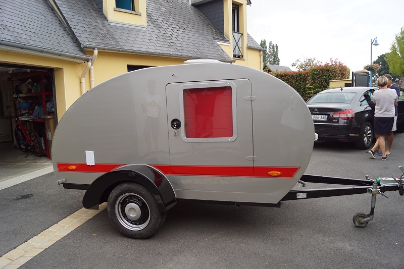

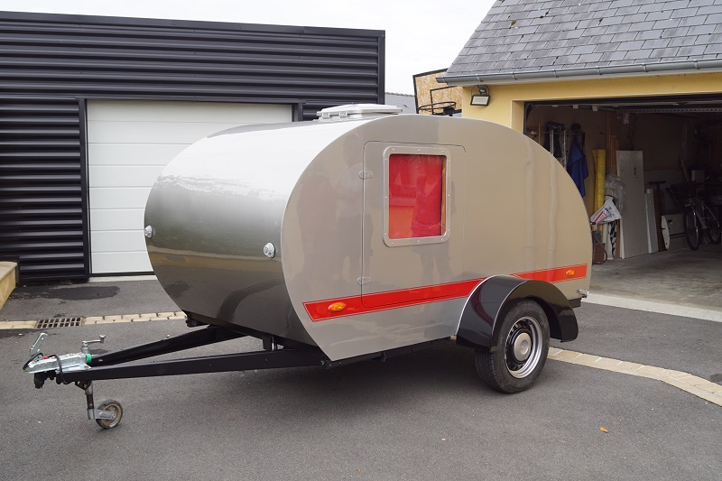

Postby guymi » Fri Aug 14, 2020 10:46 am
DSC02262 lcl.jpg (183.27 KiB) Viewed 3129 times
Larme au départ

Postby Tom&Shelly » Fri Aug 14, 2020 11:10 am
guymi wrote:Larme au départ
Bravo! C'est magnifique! :thumbsup: :thumbsup: :thumbsup:
(And that, I regret, is about the limit of my French.)

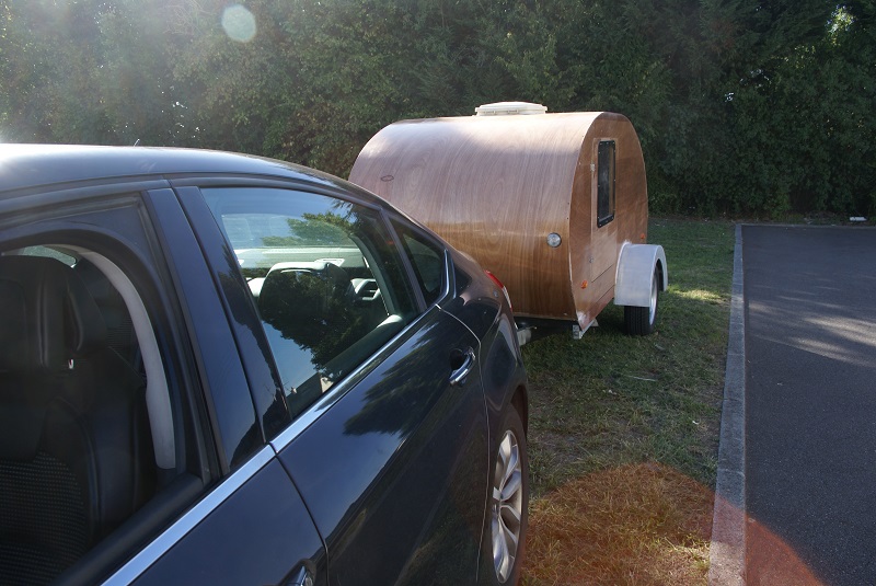

Postby guymi » Mon Sep 21, 2020 8:04 am
DSC02254 lc.jpg (180.81 KiB) Viewed 2804 times
right and left view
