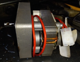

At 10 Revaluation per minute (RPM) and 2 .21 Inch pounds of tourqe I would Say it has a plastic gear reduction. not capable of cracking peanuts :roll:
I have a slow treager auger gear reduction but it's 110, fan spins like crazy, then gear drive for torque, and they seperate i guess, there are screws.
yours if it would help, but a new one might be cheaper then shipping.
with fan.jpg (36.31 KiB) Viewed 1150 times
gear drive.jpg (27.28 KiB) Viewed 1150 times
