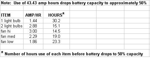

Yes, seeing is believing (sometimes). I can see why using a meter to monitor battery usage while camping is not very practical. However, my testing has provided me with usage results. I used about 43 amp hours before the battery reached 50% capacity. I made the Excel chart below that shows approximately how many amp hours use I'd get out of each 12V electrical item in the trailer.
With that, I can estimate my amp/hour usage while camping. For example, if during a two day/night trip, I use my dual light bulb fixture for 3 hours each evening, and my single buld fixture over the galley for 1 hour each evening, I can use my fan on low for about 12 hours total, or on medium for about 10 hour total.
