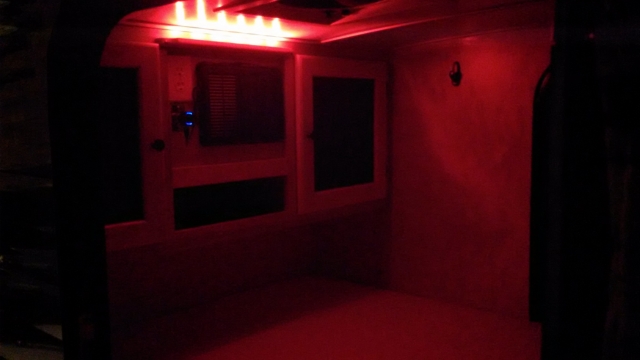

Here's what it looks like running...

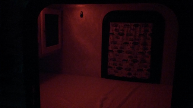

This photo makes the light look brighter than it really is. This is more how the light looks in the camper...

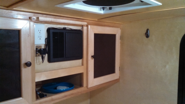

Essentially this is a length of 1 x 2" Maple with some decorative cuts on the ends and a Ogee shaped edge. The real trick to getting the glow in the teardrop was to use a 90 degree router bit to cut a channel in the top of the wood. This points the LEDs at the ceiling at 45 degrees.
http://www.amazon.com/Freud-20-104-Diameter-90-Degree-V-Grooving/dp/B00004T7DZ/ref=sr_1_1?s=hi&ie=UTF8&qid=1434307181&sr=1-1&keywords=90+degree+router+bit+1%2F4%22+shank&pebp=1434307185391&perid=BED98D9E9B1A41DAA746
An improvement that could be made is use an opaque piece of plastic to soften the LEDs against the ceiling. Without this, we ended up with six stronger pools of light. It isn't unpleasant.
Using the Antec light keeps things very simple as we use the USB charger most every night to charge our phones. The light itself has a power switch inline which we siliconed to the wall above the converter.
