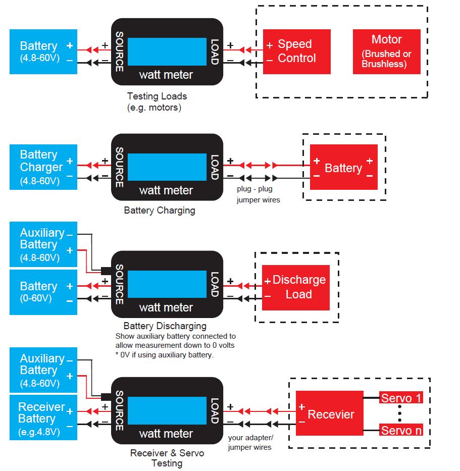

Postby capnTelescope » Mon Feb 15, 2016 1:14 pm
Not to be a wet blanket, but ...
Based on this excerpt from the G.T. Power RC data sheet:
G.T. Power RC.jpg (105.75 KiB) Viewed 4092 times
I don't think this monitor will give a continuous charge/discharge indication of battery state of charge. Look at the second example in the illustration. This shows the monitor hooked up for charging, with the battery as load. As shown, it will show the amount of charge added during charging. To show the amount of battery amp-hours used, see the other 3 illustrations, where the battery is connected to the source connection.
In other words, the power monitor can show how much power is used from or added to the battery since the last time the monitor was connected, but not both nor the net state of charge.
Being the power monitor is for RC models, it's probably not intended for on-board use. I'd go for a simple volt meter.

Postby Trevor57 » Mon Feb 15, 2016 10:23 pm
capnTelescope wrote:Not to be a wet blanket, but ...
This unit IS a volt meter.
