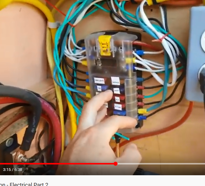

Postby Wellcraft290 » Mon Nov 18, 2019 12:30 pm
https://www.youtube.com/watch?v=oj0we2v3d3s
at 3:15 in this video
see has red on the top right and black on the left on the same post?

Postby tony.latham » Mon Nov 18, 2019 9:25 pm
I don't know what he has going on there. Here's how it should be wired:

So I like the idea of a converter. but you can use the converter and hook to the blue bus fuse positive to positive and it will back feed to charge the batteries? that is what I am trying to figure out more then anything.

...and hook to the blue bus fuse positive to positive and it will back feed to charge the batteries?
I finally figured out you were referencing the Blue Seas fuse block and not a blue-colored bus. But yeah, continuity is continuity.

Postby Rainier70 » Sun Dec 08, 2019 9:19 pm
He does have it hooked up to the positive and negative poles of the Blue Sea distribution box. The part that is confusing is the color of his wire that goes to the top negative post is red when all the other negatives are white or black. If you look at the picture at about 3.20 you can see the relatively short positive wire that he has going directly to the bottom of the Blue Sea box from the converter. It appears to be red also which really makes it confusing. Coloring or painting part of the negative wire to show its polarity would have helped.
