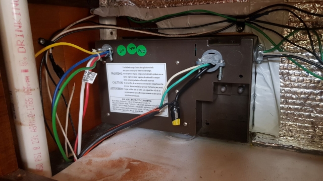

Thanks for the quick response! And good advice, tracing it back led us to the inverter and the wiring from inside the trailer (see pic#1). gallery/image.php?album_id=5268&image_id=166290

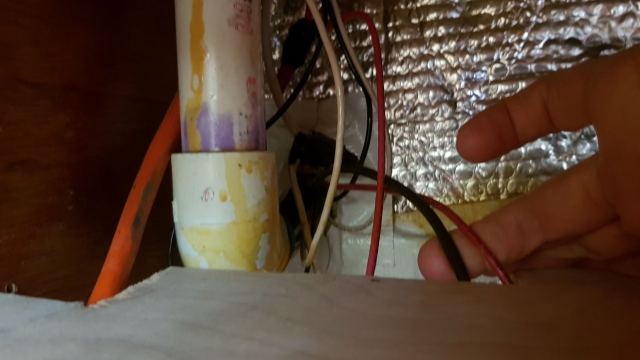

It looks like the white and red wire come from the inverter. (see pic #2) gallery/image.php?album_id=5268&image_id=166289 On the inverter label, it says "Red wire to battery positive", that seems clear.
But then it says "white wire for negative #10GA circuit." And that makes me a little confused because there are two white wires coming from the inverter. One on the same side as the red wire. And one grouped with a black and green on the other side. The white, black, and green all go to an extension cord plug for our street power connection. So, what is the white wire coming out with the red. Is it the white wire for negative #10 circuit? Or something else?
The black and red wire come from inside the trailer somewhere (see pic#3) gallery/image.php?album_id=5268&image_id=166288 If the red wire from the inverter goes to battery positive, where does this red wire go? And the black wire?

I see two sets of black, white, green. One set through the more obvious port in the rear of the inverter. There is a second set through a port on the inverter case side. Which set of wires connect to the extension cord plug? Is the plug you mentioned a male or a female?

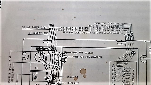

Thanks! Again, good advice. Found the "manual" which is 4 pages long. ; )
From the picture, it looks like the red and white coming out the same side are the positive and negative connections to the battery. So that is solved.
My remaining question is, what are those black and red wires coming from inside the trailer. Is one of them the ground? What is the other one? 166298

That does not look like an inverter. It appears to be an AC/DC power distribution box or panel.
The group of 5 (white, red, yellow-striped, green-striped and blue appear to be DC power. White and red connect to battery and the other three distribute 12 VDC power to various devices in the trailer.
The three wires named 30 amp power cord, would be connected to the power plug that would be plugged into a campground pedestal or a generator. There could be one or more AC outlets installed in the trailer. Those would be powered by the incoming 120 VAC when or if the trailer is connected to the campground or a generator. One set of those white, black, green triple grouping would be connected to the plug you mentioned and the other group of three (white, black, green) would distribute the 120 VAC power to the one or more standard outlets.
There should, or could. be some fuses or circuit breakers. One or more for the 120 VAC power distribution and likely three for the 12 VDC power distribution. That is a guess but it would be logical to me.
FYI, with 120 VAC power, the green should always be the ground wire, which in a cable such as household romex will be the bare wire that is grouped in the sheathed cable that includes the white and the black. The black should be the hot wire. The white should be the neutral wire. I say "should" because I don't know if it was all installed correctly. Also when the AC wires are traced back to the plug, the white wire should be connected to the wider of the two flat prongs, the black connected to the narrower of the two flat prongs and the green connected to the roundish prong.

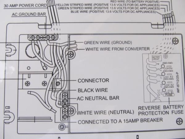

* I found a similar wiring diagram by searching Google.
WFCO wf-8712 30 amp converter
https://www.doityourself.com/forum/electrical-ac-dc/526249-30-amp-converter-breakers.html
It looks the same as yours
cleaned up and made easier to view
wfco wiring.jpg (105.15 KiB) Viewed 1473 times
173193172890148599

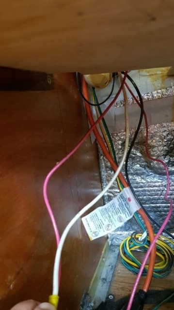

I followed the red and black wires through the wall between the battery compartment to the sleeping compartment. Where I see that they are connected to the other face of the converter, which holds the fuse panel (see pic)166307. The thicker gauge black wire is attached to the top of the fuse panel, and the red wire is attached at the bottom.
So to summarize, in the battery compartment, I have 4 ring connectors to do something with. A white wire with ring connector and red wire with ring connector, which come from the converter and are labeled for the negative and positive poles of the battery. Then I have the black wire with ring connector and red wire with ring connector that are coming from the fuse panel, and I can't tell from the manual where or if those are supposed to be connected to the battery. 166306
Those would connect to the battery for two purposes.
1. to allow the converter to charge the battery when the converter is connected to 120 VAC
2. to allow battery power to flow through the converter DC section when the trailer is not connected to a 120 VAC source.
Then I have the black wire with ring connector and red wire with ring connector that are coming from the fuse panel, and I can't tell from the manual...
It would seem this is an accessory fuse block. It is not mentioned in the manual because WFCO did not supply it. THose would connect to the battery to distribute 12 VDC power. Usually, the red would connect to positive and the black to negative.
