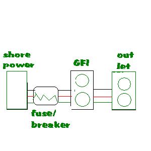

Postby madjack » Mon Sep 11, 2006 11:02 pm
...John...excuse my poor use of paint.......... 8)

Postby Micro469 » Mon Sep 11, 2006 11:35 pm
Thanks Guys, that helps. the only thing I'm not sure of is the breaker.. That means I have to put a breaker box or a fuse box in right? any thoughts on a small one?
