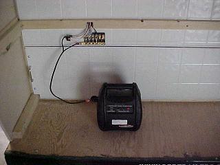

Here's what I used - a cheap jumpstart battery from Sears. It has a 12 volt outlet on the left side. I used a cigarette lighter type plug in it which is wired to the tear through a fuse block. The two unused fuse holdes contain spare fuses. It has worked fine for powering two reading lights and a 5" TV/radio for a couple hours with no noticeable voltage drop.
