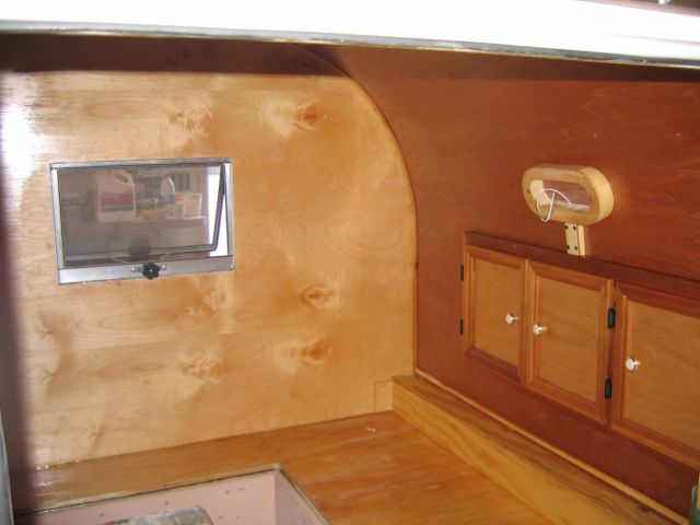

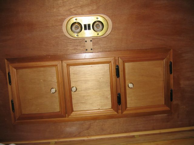

Here is the way i did the light install.

Postby Tripmaker » Tue Dec 05, 2006 9:04 am
Looks good jplock! It looks like vent holes could be put in the sides of that housing to let the heat out if necessary.
