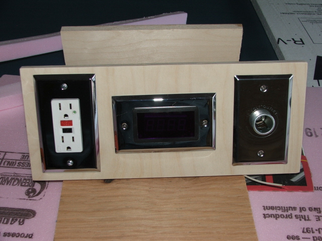

Postby bledsoe3 » Wed Dec 20, 2006 2:58 am
I'm with Steve. I have one 120v and one 12v in both the cabin and galley.
Link to galley power. http://tnttt.com/album_ ... ic_id=2971
