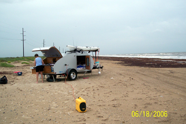

I also have a 2000 xanatrex and I used 2 4D 125 amp battery's and tried it out. It ran it fine but the amp draw was too much to be comfortable with. I put a amp clamp on it and experimented. When it started out it was pulling 34 amps. The trouble is as the battery voltage drops the current increases. after only 10 minutes the amp draw was 37 and after 30 minutes it was over 40. At that point I realized that it wasn't going to work.
As MJ has suggested I bought a Kipor and it works great. It is very quiet.

Running the AC on the beach.
