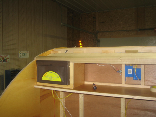

First I have installed my converter as shown in the picture but have since installed a 3" vent for cooling in that panel on the right. I notice that the converter does generate a small amount of what I'll call warmth as opposed to heat. Do you guys think the vent is enough to keep it from overheating?
