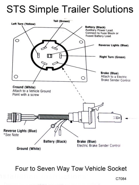

four to seven
Postby retiredcamper » Tue May 08, 2007 11:36 pm
I installed the wiring harness but it was a four prong and my trailer is a seven prong. Like I said earlier I don't have trailer brakes or a backup light but still wanted to be able to charge the battery while driving.
I was able to come up with the following and it works great. A simple plug-in, drilled two holes in the bumper and I was set. It really looks great.
Oh, since the power was not on the four prong I will have to run a fuzed line from the battery to the back. I think I can handle that.

retiredcamper wrote:Oh, since the power was not on the four prong I will have to run a fuzed line from the battery to the back. I think I can handle that.
You'll also want to isolate the trailer battery from the truck, at least while the engine is stopped. An easy way to do that is to use a Ford-type starter relay, energized from the ignition switch. This will prevent the trailer battery from discharging the truck battery. While the engine is running, the batteries will not be electrically isolated with this setup. The higher capacity battery may not charge fully.
The other option is to use a battery isolator, which is simply two high current diodes in a heat sink. This will prevent the aforementioned discharge, as well as allowing both batteries to charge to full capacity.
Happy trails.
