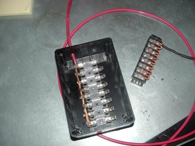

Adding these
Mike S set up
from here
http://tnttt.com/viewto ... lock#11309
Postby Mike Angeles » Mon May 14, 2007 9:41 am
My Thinking was that since it will be enclosed in a box.,..........More or less the same thing? Bus Bar kind thingy. using the 8 ga. wire to all my Fuses enables me to take advantage of Higher gauge. wires to other circuits as needed. In the Photo you show your limited to what the wire that feeds the previous circuit, Only as strong as the weakest link?
Just a thought,
Mike

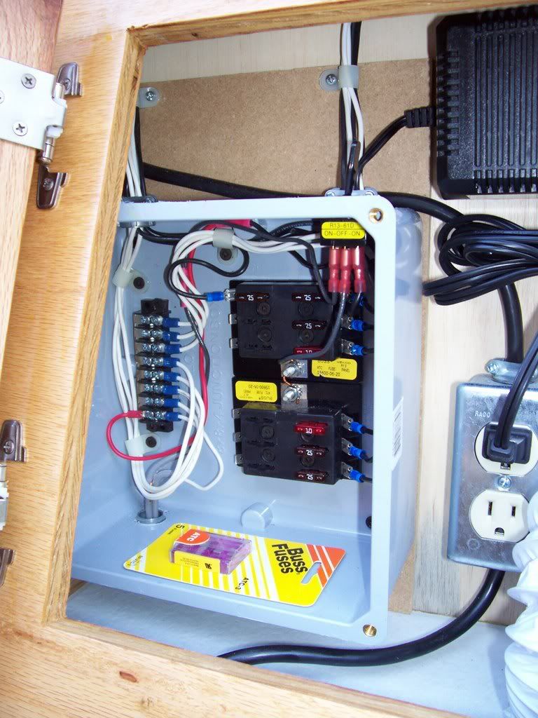

Postby IndyCubby » Mon May 14, 2007 11:11 am
Here is how I did mine...
I prefer the automotive plug style fuses rather than the old glass kind because they look a bit cleaner and there are fewer conductive parts exposed.
To make things a bit easier to wire, you might find another type of fuse block where all of the circuits get power from a common bus (like the one in my picture). What you are trying to do would work o.k., I would just be concerned that your main wire may come unsoldered or something.

Postby Dale M. » Mon May 14, 2007 11:52 am
IF fuse assembly is in enclosure, I see no reason to not solder it. An exposed buss bar inside a enclosure is not a problem...
Using multiple loops from connector to connector just makes for more places for mechanical connectors (push on) to fail .... But there are also times when it is only solution.
I'll go along with IndyCubby on the ATO/ATC fuse panel style. The built in buss bar is a plus and the blade type fuses (ATO/ATC) are a lot easier to work with. Some of the blade type fuse blocks also have additional GROUND buss bar included. There is also a type of blade fuse available that has a LED included in its construction and it lights up (indicates) when fuse blows...

Postby Mike Angeles » Mon May 14, 2007 12:58 pm
Excellent, Unfortuneatly , Im already committed to the one I have ($). So ill give it a shot, very clean install you have there, Impressive.

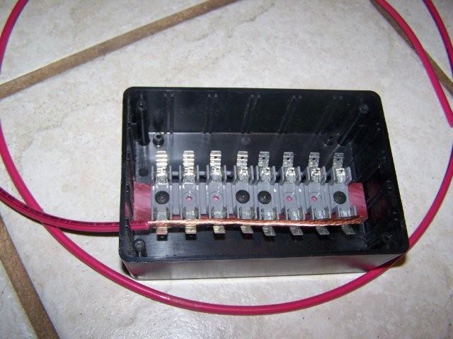

Postby Mike Angeles » Mon May 14, 2007 5:24 pm
And heres the result, Solder joints all look ok, I used a cheapo pen torch. didnt do too much damage. If this fails ill invest in something a bit more modern. As in most things in life, it looks alot better at 3' then it does at 1' 8 ga. was a bit much in hindsight.
Mike

Postby Chuck Craven » Mon May 14, 2007 10:36 pm
Sorry Mike, But what you have is a firetrap! :thumbdown: You would be better to use a terminal strip like the black wire is wired. Then run #10 gage wire from the terminal strip to the fuse blocks with a push-on connector. Solder is not an electrical connection device, it’s a mechanical method to hold wires. Yes it is used in the electronic industry but after the fused supply, not before it. Solder melts at 550 dig.F Plastic box starts on fire at 300 dig.F. I would suggest you redo the supply wiring. Use solder wick to get off as much of the solder as possible and rewire with push-on connectors.

Postby Mike Angeles » Tue May 15, 2007 6:08 am
Chuck thanks for your concerns, I feel confident in the connections made so far.
