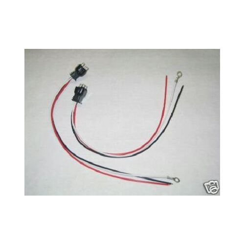

I had a problem with the break/turn lights I installed. The 3 wire pigtail plug stuck up to far and the skin would not lay flat. :thinking:
So I got to thinking and sacrificed a pigtail to see if my idea will work. I boiled it in water to soften it up and carefully cut the wires and terminals out of the plastic. Then I put some heat shrink on the wire around the terminal and pluged them in to the sockets. Then filled the socket with silicone.
Sorry, I didn't take a picture of the pigtail before, But this is what the pigtail looked like)
It works good for installing the skin, but I don't know yet if the lights will work....wish me luck.

:o Now I know you are fairly careful but I will ask just in case. You did soldier the wires first, right? :thumbsup: Good girl. :lol: I sure hope it works for you so I can borrow it if I ever get some fancy lights. 8) :thumbsup:

:shock: Huh??? Solder?? What.... :D JK, The pins and the wiring came out if the plastic still crimped good, so I just covered the exposed wire with heat shrink, plugged em in and gooped the silicone on it!
Ya think I need to go back and solder???

Mary K... Looks like a darn fine job to me. That plastic didn't serve any purpose than making it easy to plug-n-play. The crimped on connectors are used for virtually every connection on modern cars and work just fine. About the only problems are the ones exposed to the weather... and yours are not. Plus, it would be an easy fix from the outside... just unmount the light and fix if ya ever need to. I'm all for soldering when necessary... like permanent wiring hidden in the walls, ceiling, etc.
Lights and stuff you can get to easily... No biggie. :thumbsup:

...slick fix MK...as to the wiring, I wouldn't worry too much about soldering it together...several times in my trucking career I have had to make a similar repair when a light went out and the pigtail was messed up...in those cases, I just plugged it up and went about my business...even went so far once to cut the pigtail off and "make" the insert connector by wadding up some wire and putting a drop of solder onit and shoving it into the back of the light...a piece of duct tape to hold it all secure and down the road I went....

I think crimped connections are fine. We use a few at work.

Cool Beans Everyone!!! :thumbsup: Its A go!!! The lights all work fine.
Now if I can just figure out how to wire the Amber light. Does it stay off and blink with the blinker/break light or stay on as a running light? Its kinda bright.... :scratchthinking:
It's weird, the red light has a low light wire and a bright light wire. I assume the low light is wired to the brown (on all the time)and the bright light wire is wired to the break / blinker wire. Now the Amber has both wires but only the bright one works. What does this wire to? The brown or the break/blinker?
Thanks!!
