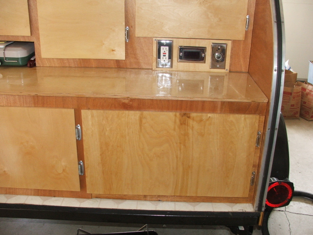

Postby bledsoe3 » Tue Jun 12, 2007 9:03 am
Sorry Phil, I sent the wrong link. This is how mine is mounted.
Mine is a voltage meter, not an amp meter.
