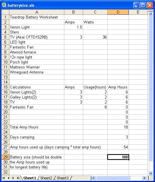

Since this question comes up from time to time, I figured I'd put together a quick little spreadsheet.
What I need your help with is what is the amps, or watts, of some common items that we teardroppers use. As you can see below, I don't have much yet.

Here's most of the loads you needed.
Usage Worksheet from RV Solar

I like that. Thanks Bruce!
