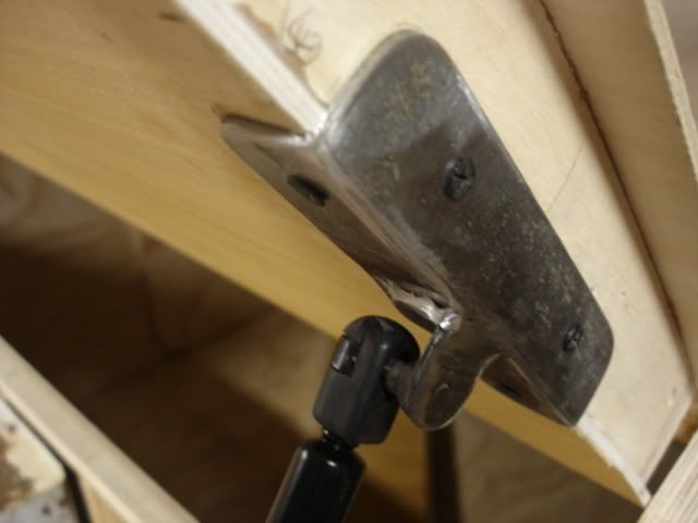

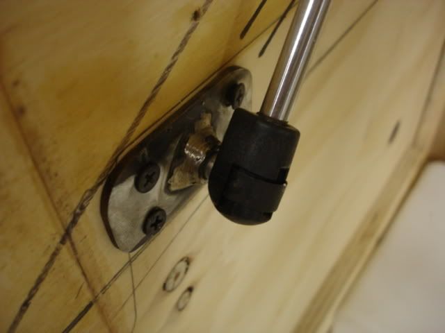

BTW-- your hatch struts, I noticed you have a different top bracket than I have seen. Could you tell me what you used and where you got it?? Pleaseeeeeee. Thanks. :thumbsup:

I couldn't find any strong enough (or cheap enough) so I made my own out of some 1X1" angle and some grade 8 nuts and bolts.I cut the head of the bolt and turned a groove in it using my drill press as a lathe,
I welded the nuts on the angle with my MIG and just screwed the turned
headless bolt into the nut. They worked out perfect and only cost about $3
for all four. These pics were taken before I cleaned and painted them. Thanks! Aaron

Great pictures Aaron Thanks.

That's nice, I had the same problem on my first tear. McMaster Carr carries the stainless steel ones so that's what I used. Made the attaching points steel like yours except my hatch frame is steel so I welded them to the hatch.
